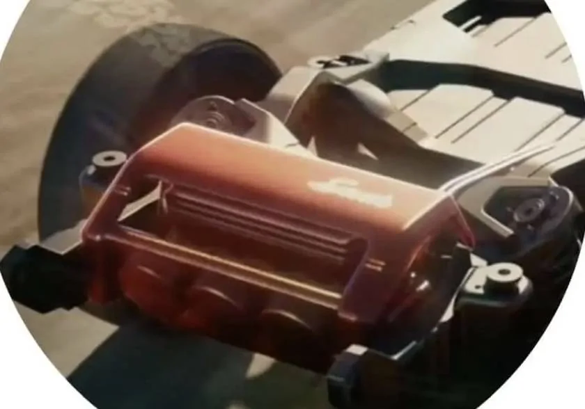

If the Harvester's trailer tow capacity is really only 5,000 lbs., the weight of the engine sitting behind the rear axle might have something to do with it. The BEV version has the entire weight of the (larger, heavier) battery pack forward of the rear axle.
Referring to this (admittedly an early 'artist's conception' of the Harvester unit):
...makes me think even more that the 5,000 lb. tow limit is likely a result of having that much weight that far behind the rear axle. If we assume that the Harvester genset weighs, say, 300 lbs., that's almost like having 300 lbs. on the trailer hitch even before there's any trailer hooked up. The wheelbase isn't that long either, meaning the steering axle has less leverage on the trailer hitch (which may be the main reason the Terra has a lower tow rating than Traveler.)
If they'd sacrificed the 'frunk' the Harvester would have added weight to the steering axle instead, and resulted in a more well-balanced configuration (for towing).
$5 says you’re right. Makes perfect sense…and once again, I really hope they armor the shit out of the underside of that area.
if you’re right, then I could see Scout upping the capacity back to 10K with a WDH. Rivian makes the same claims with their towing capacity - the full rating is only with a WDH and is halved otherwise.

AFAIK, 5,000 lbs. is the limit without a WDH.
IOW, a WDH is required for more than 5,000 lbs "conventional" towing regardless of the total tow rating (even HD pickups that are rated to tow upwards of 18k lbs.)
So I wouldn't assume that having a WDH will increase the tow rating.
