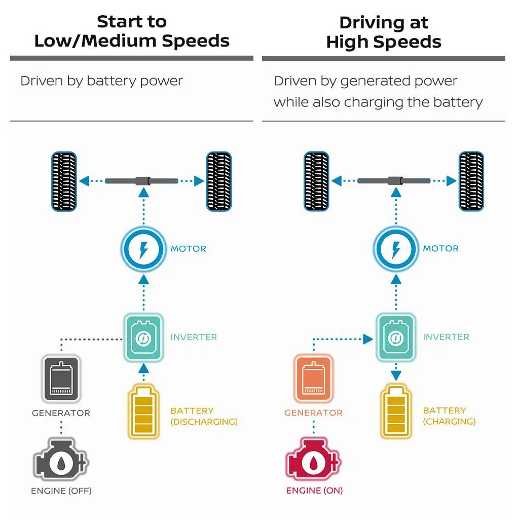

Except GM (Volt) and BMW (i3) and Nissan (ePower) have already done it this way. The inverter acts like a router for the power coming from the generator. Routing the generator power to the drive motors preferentially, depending on demand, any excess power gets routed to the battery, any deficit gets supplied by the power already stored in the battery. Less conversions from A/C to D/C or D/C to A/C, more efficient.
From Nissans website
Listen to the Nissan engineer explain it
