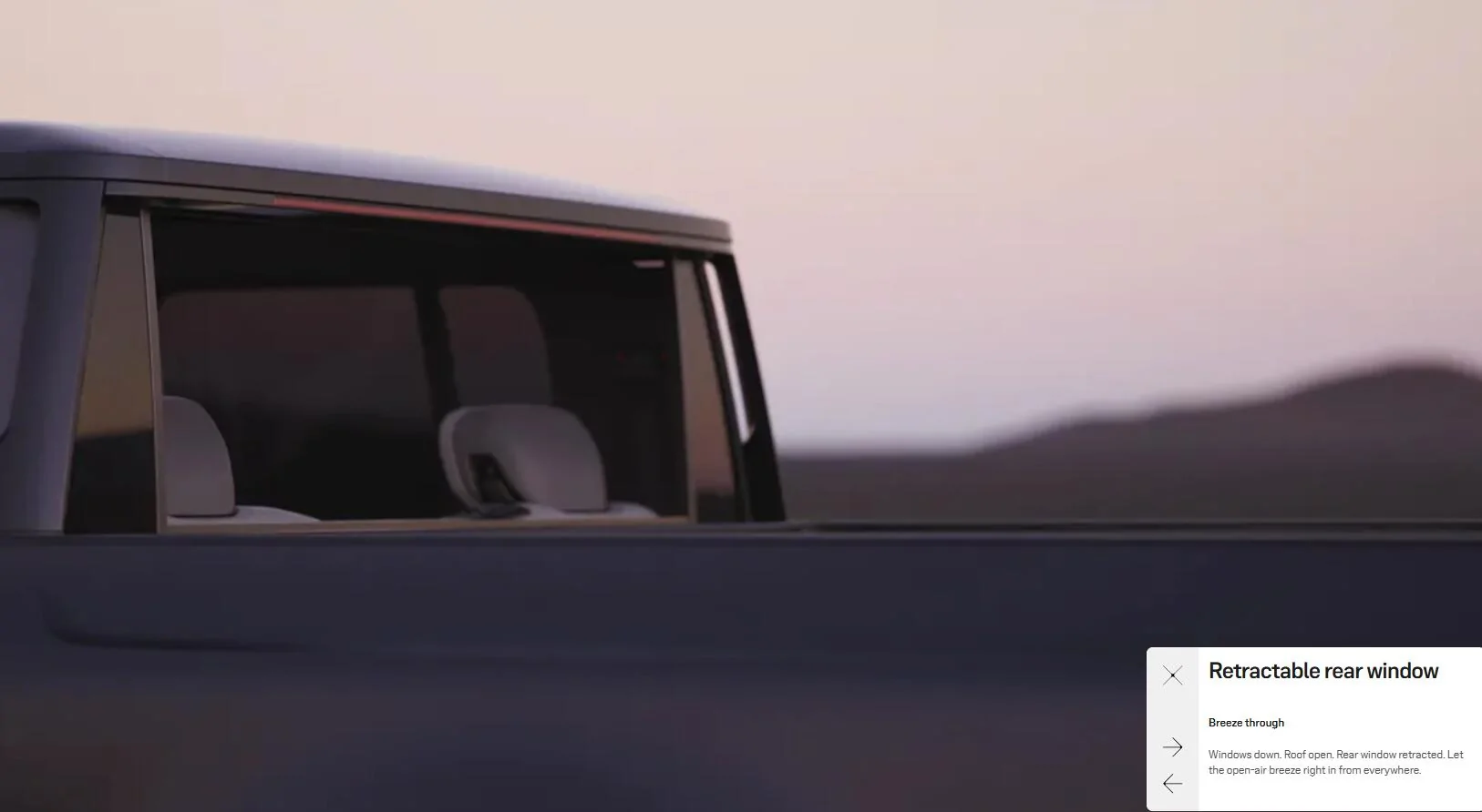

The rear window is confirmed to be able to be retracted, this will give some access to the cab for HVAC while camping.
I would not expect there to be a mid gate option, that would require a unibody construction and from what I can tell, the cab and bed are seperate.
Yup love the back window roll down. I've always been jealous of the Tundra, but this vehicle kinda is a unibody right? It all sits on a massive flat battery pack that the body is built on. I'm not sure if there's a technicality of why this wouldn't be a unibody?

Both the Terra and Traveler are going to be body on frame. In unibody the body has structural members built into it and the drive train components bolt to that. In body on frame there is a separate structural frame that the drive train components attach to and the body sits on top as a separate piece. Makes for a stronger design and better suited for any abuse thrown it's way while off road. For Scout it looks like they plan on installing the battery packs inside the frame area to use that available space and help to keep the batteries protected. I'm not sure how the batteries are attached on most other electric vehicles that are unibody but i would assume there's just a built in recess in the underside of the body that a separate battery pack housing fits and bolts into.
