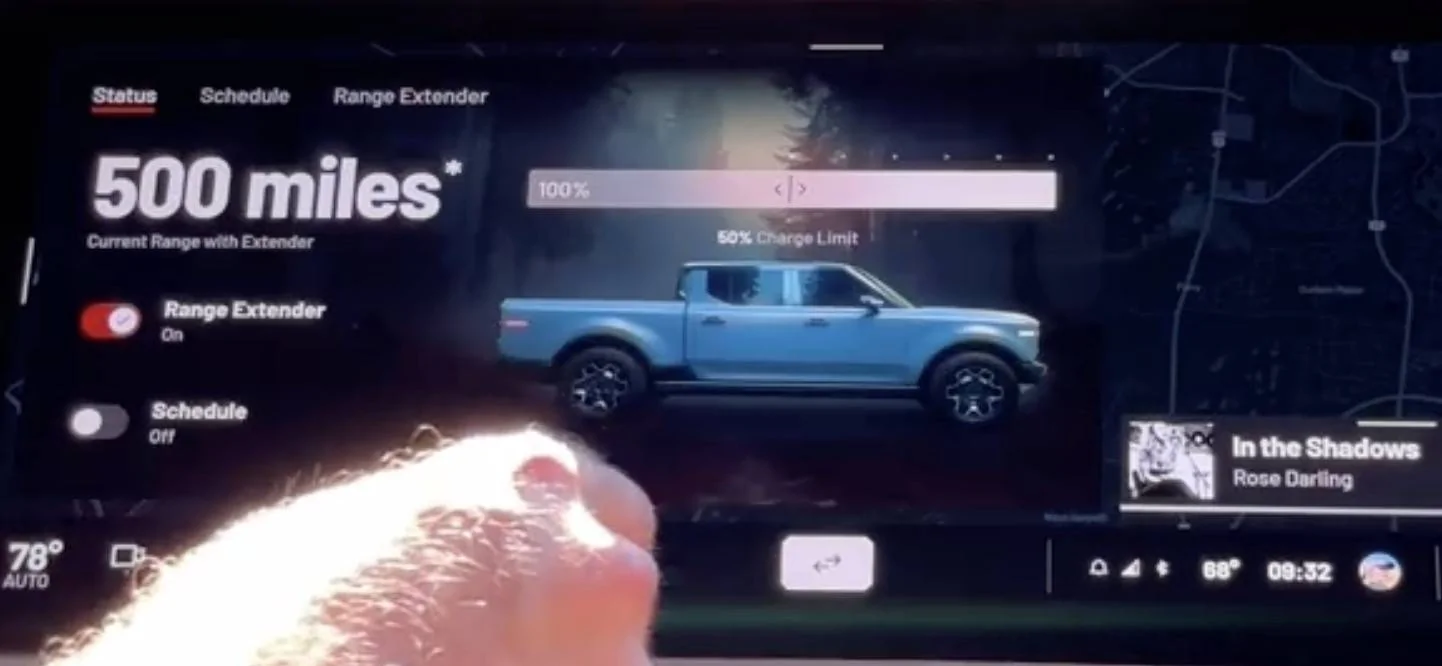

Range Extender can be turned off / disabled via menu setting screen
