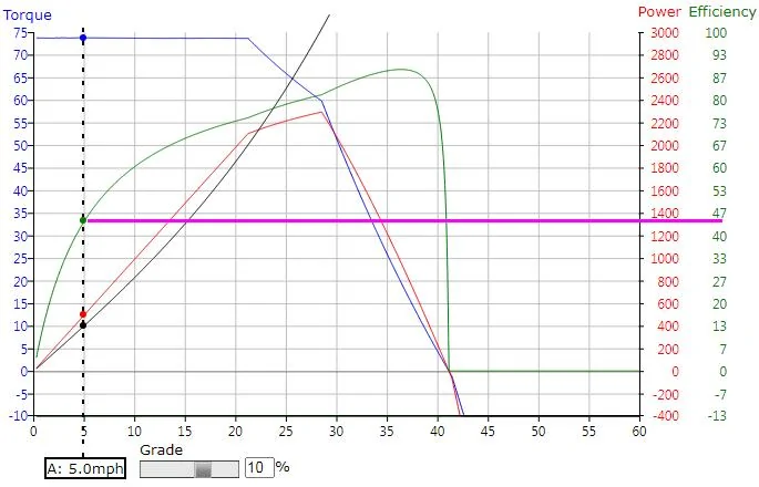

But when going off-road on terrain that is rough enough to require 'creepy-crawly' speed, there is an often-overlooked problem with not having low range gearing. The motor's efficiency is significantly reduced at such low speeds.
On a normal road, even if the GVW/GCW is maxed out, this isn't a problem because the vehicle accelerates past that very low speed in seconds. But if the terrain itself forces sustained on & off 'creepy-crawly' speed - especially if pulling a heavy load up a long hill - the motor efficiency is going to be significantly worse than normal. This will result in more energy being wasted as heat (possibly stressing the cooling system, which also won't have much airflow), and greater range reduction.
Although a motor's windings can be designed to favor low rpms, and the motor diameter can be increased* to provide higher linear speed relative to the stator, both of those only help a little, certainly nothing like having an extra 3:1 gear reduction for low-speed off-road work.
The attached image shows torque, power & efficiency curves for a very efficient brushless 3-phase e-bike motor (EV motors will have higher peak efficiency, but their efficiency curves are similar). Full torque (blue line) is available at very low rpms. But at at 5mph up a 10% grade, efficiency (green line) is about half compared to the peak efficiency range.

My post is not about throttle control, nor does it state that EVs may need a low range because of insufficient torque. Practically every type of EV motor produces peak torque at much lower rpm than an ICE. The chart I posted is a good example.
What’s really important here is how the motors function at 1-2mph. How they respond to throttle inputs from a rest to 1mph...
True, and especially pertinent considering that EVs don't have any slip mechanism comparable to a torque converter. But fine control at very low speeds can be accomplished by programming the motor controller to ramp up the output more slowly (relative to throttle pedal position) in an 'off-road' mode. Presumably Scout (and others seeking to optimize for very low 'creepy-crawly' speed) will do that.
But that's a different issue than the point made in my post: that under these conditions, EV motors will waste a lot more energy as heat than they do at faster speeds, and that extra heat won't be as easy to dissipate because of reduced natural airflow at very low speed. Hopefully the cooling systems will have enough fan-forced airflow to compensate.
