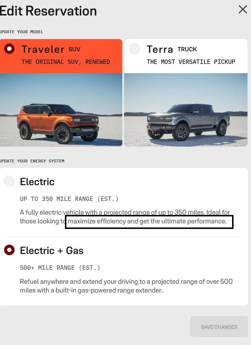

I've opted for the Harvester configuration. Based this reservation detail, I suspect the power may be down a bit in addition to the smaller battery. However, having no range or charging anxiety is a win. I also have already suffered the massive depreciation on my Two Mach-E's....I see a EREV as being the sweet spot for giving me what I want with an EV while allowing me to keep value in the vehicle as it would be a more appealing option to a wider audience.
