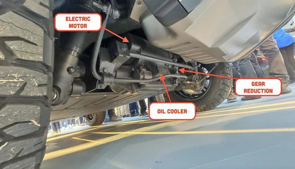

Couple questions I have in mind after seeing the photo. Does anyone know if the under body is protected by a “shield” from off road hazards? Also, whats the expected maintenance of EV + Range Gas Extender?
A full EV doesn’t have to worry about oil change and everything else a gas engine would need. So I’m curious how the engineering/mechanics work with Harvester.
